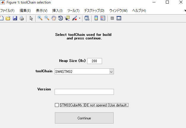

After that, I set PC COM Port, selected the type of STM32(STM32F401RETx) and selected STM32 COM Port.
then, I selected the SW4STM32 as a toolchain and clicked continue without checking ''STM32CubeMx IDE not opened''.

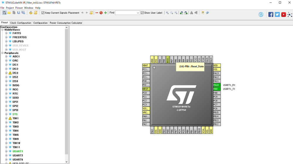

And I got the display of STM32CubeMX IIR_Filter_int32.ioc. So, I pushed ''generate source code based on user settings ''.
And then, I could generate following files. I'm using System Workbench for STM32.

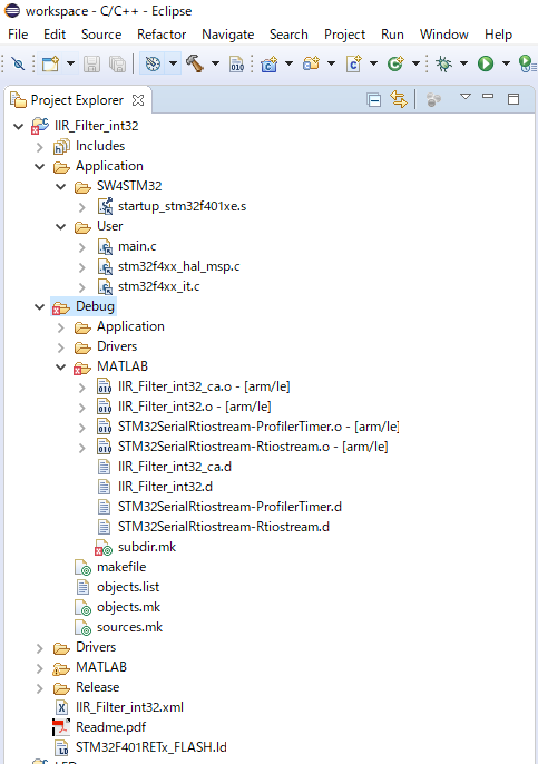

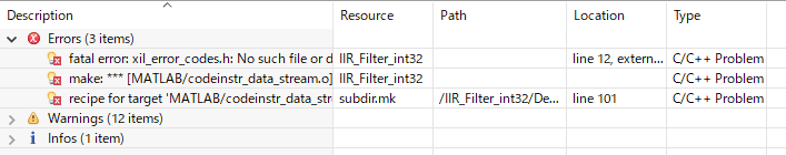

However, if I push the button for Building project, The system says that there are some errors in the program.
It seems that there is problem in subdir.mk.
It also says ''C:/Users/k.sasaki/Documents/MATLAB/IIR_Filter_int32_PIL/IIR_Filter_int32/Inc/xil_interface_lib.h:12:29: fatal error: xil_error_codes.h: No such file or directory'' and ''MATLAB/subdir.mk:101: recipe for target 'MATLAB/codeinstr_data_stream.o' failed make: *** [MATLAB/codeinstr_data_stream.o] Error 1''
I don't know why the system says these error because I'm just following the reference of the program.

You shall include all the missing header files from MATLAB installation folder.
For example xil_error_codes is found on:
c:\Program Files\MATLAB\R2017a\toolbox\rtw\targets\pil\c\
Note: I have Matlab 2017
If you use System Workbench for STM32:
- right click on the project Properties
- C/C++ Build -> Settings -> MCU GCC Compiler -> Includes and add the path of all header files in there.
Good luck!

As far the toolchain is concerned there are known issues with eclipse-based tools, especially for include paths and build resources that can be defined as excluded.
It is an issue with the project generator that is used.
In the current situation, in the project generated for these types of IDEs, check the include parameters for the paths and verify that the build resource is also enabled.
