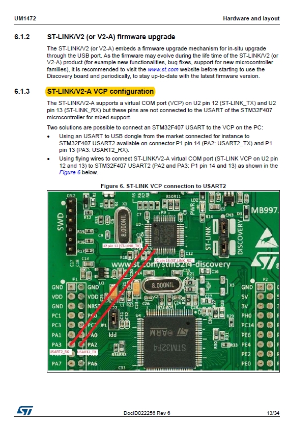

Hi, everyone
External mode require VCP(Virtual Com Port) in the configuration but the
http://www.st.com/en/evaluation-tools/stm32f4discovery.html
's virtual com port are not available. because ST-Link are not connected to the USART of the STM32F407.ST-Link of old reference doesn?t support VCP at all.
ST-Link of the new ref (
) support VCP but is NOT connected to target.So, if you want to use it must do configuration as shown in below picture.

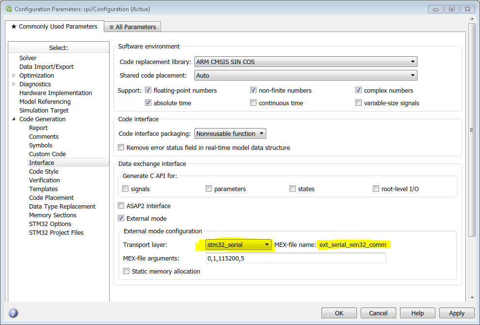

Do you use USART as the communition? If so, please do check, wether the MEX-file name is ext_serial_win32_comm.
Although you selected USART as the communication while generating the code, but actually the MEX-file is still ext_comm, which means that TCP/IP will be used as communication. This bug will lead to the error when you try to connect to your target. According to your error report, your MEX-file is ext_comm.

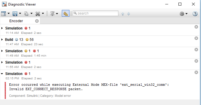

I used USART3 as the communication, since it's already connected to my STM32F429 board through ST Linker. ( I had test it in the past and working properly). Also, I enabled USART3 pins that I used in CubeMX.
Regardings the MEX-file, I checked and it's, as XJ Q mentioned, ext_comm. So, when I modify it to
ext_serial_win32_comm (Just by clicking on stm32_serial tow times through transport layer options), the previous error cleared and another new error message occurred
.I attached a snapshot for new error.
So do you have any solution.

2. When you select stm32_serial for Transport layer, MEX-file name stay ext_comm. But this will cause the famous error, so you have to deselect stm32_serial and sellect it again to change the MEX-file name to ext_serial_win32_comm
