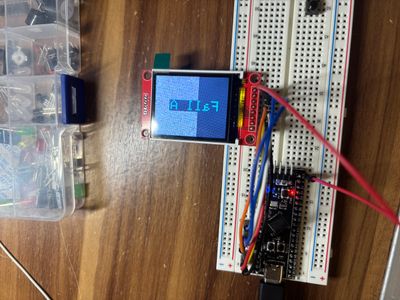

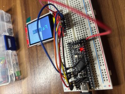

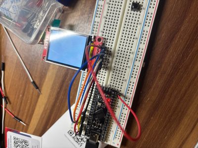

2025-09-14 5:53 AM - last edited on 2025-09-15 9:22 AM by Amel NASRI
Best regards,
Michael
#include <Adafruit_GFX.h>
#include <Adafruit_ST7735.h>
#define TFT_CS PB10
#define TFT_RST PB0
#define TFT_DC PB1
#define LED_PIN PC13
Adafruit_ST7735 tft = Adafruit_ST7735(TFT_CS, TFT_DC, TFT_RST);
void setup() {
delay(200); // kurz warten, bis das Display Strom hat
pinMode(LED_PIN, OUTPUT);
tft.initR(INITR_BLACKTAB);
tft.fillScreen(ST77XX_RED); // Bildschirm rot füllen
delay(1000);
tft.fillScreen(ST77XX_GREEN); // Bildschirm grün füllen
delay(1000);
tft.fillScreen(ST77XX_BLUE); // Bildschirm blau füllen
void loop(){
digitalWrite(LED_PIN, LOW); // LED an (bei STM32 oft invertiert!)
delay(500); // 500 ms warten
digitalWrite(LED_PIN, HIGH); // LED aus
delay(500);

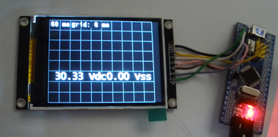

if you want , can try my lib... --- no. I just see: your on Arduino... i use the STM32CubeIDE , different.
But Miss Adafruit's Lib should work fine.
Just try : init green tab (as your tft seems to have a green tab ! )
not
2025-09-15 4:39 AM
thanks for the help, I already tried red, green and blue tab. I also tried to use the CubeID but to be honest it was a bit overwhelming. But i would like to give it a second try with your library because i couldn't find an F4 library without any mistakes in it.

ok, but its used with/in CubeIDE , so...try with this.
You have to edit here the pin + spi numbers, to fit your connections:
void spiwrite(unsigned int8 spidata){
#ifndef TFT_SPI_HARDWARE
int8 ss;
for(ss = 0x80; ss; ss >>= 1) {
if (spidata & ss) output_high(TFT_DATA);
else output_low(TFT_DATA);
output_high(TFT_CLK);
output_low(TFT_CLK);}
#else
SPI1->DR = spidata; //spi_write(spidata); HAL_SPI_Transmit(&hspi1, &spidata, 1, 1); hspi1.Instance->DR = spidata;
#endif
void write_command(unsigned int8 cmd_){
GPIOB->BRR = 0x00C0; //GPIO_PIN_6;//HAL_GPIO_WritePin(GPIOB, GPIO_PIN_6, GPIO_PIN_RESET); //output_low(TFT_DC);
// GPIOB->BRR = GPIO_PIN_7;//HAL_GPIO_WritePin(GPIOB, GPIO_PIN_7, GPIO_PIN_RESET); //output_low(TFT_CS);
SPI1->DR = cmd_; // spiwrite(cmd_);hspi1.Instance->DR = cmd_;HAL_SPI_Transmit(&hspi1, &cmd_, 1, 1);
HAL_GPIO_WritePin(GPIOB, GPIO_PIN_7, GPIO_PIN_RESET); // als 720ns delay für spi
GPIOB->BSRR = GPIO_PIN_7; //HAL_GPIO_WritePin(GPIOB, GPIO_PIN_7, GPIO_PIN_SET); //output_high(TFT_CS);
void write_data(unsigned int8 data_){
GPIOB->BSRR = 0x00800040 ; //GPIO_PIN_6;//HAL_GPIO_WritePin(GPIOB,GPIO_PIN_6, GPIO_PIN_SET); //output_high(TFT_DC);
SPI1->DR = data_; //hspi1.Instance->DR = data_;spiwrite(data_);HAL_SPI_Transmit(&hspi1, &data_, 1, 1);
}- the comments contain variants, using only HAL call etc. ; so change and use this, if its better working for you.

Gonna try this on the weekend! Ofc greentab didn't work :)
