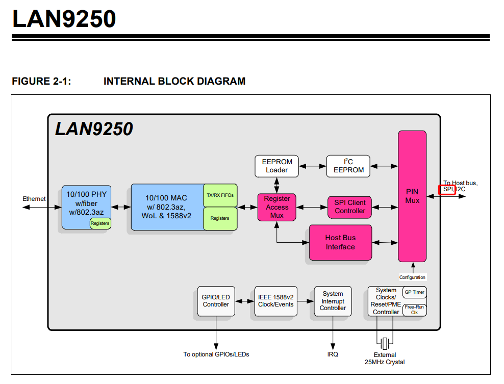

@Ranjitha wrote:I'm confused regarding the importance of SPI for Ethernet (LAN9250V/ML)
SPI has nothing to do with Ethernet as such.
The LAN9250V is an Ethernet controller which happens to have an SPI interface:
via: https://www.microchip.com/en-us/product/lan9250
Note that it's a Microchip product - so nothing to do with ST.
@Ranjitha wrote:Give some samples codes to implement this particular Ethernet
See Microchip's Product Page for their product:
https://www.microchip.com/en-us/product/lan9250#Tools%20And%20Software

2025-04-22 1:25 AM
Microchip would be the ones to ask for that.
https://ww1.microchip.com/downloads/en/DeviceDoc/LAN9250-Quick-Start-Guide-50002993.pdf
The key thing to remember is that the LAN9250 neither knows nor cares what microcontroller you use - it simply behaves as described in its datasheet.
So any driver code should be portable to an STM32.
Look for support in whatever IP stack you use.
