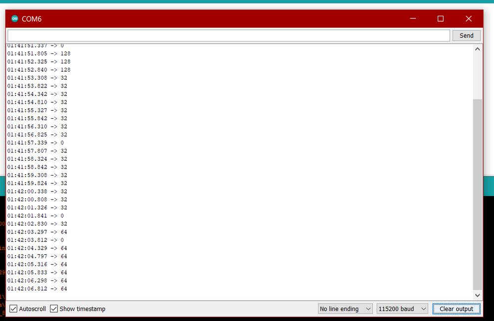

By using the serial port in the arduino I can see that it does receive data, but usually bit shifted. So if I send a 16, i usually get a 32 or other power of two in the arduino (see attached image)
I'm using clock polarity 0 and clock phase 0 on both microcontrollers (so clock idle on low and sampling on the rising edge). Just to be sure I've tried all possibilities but to no avail, it still doesn't work properly, and I don't really know why. Another thing I considered was that perhaps the clock is running too fast (the peripheral clock is set to 16 MHz), but if I change the prescaler to anything other than SPI_BAUDRATEPRESCALER_2, i stop getting any data on the arduino, only 0s, which I find odd, I would expect it to work just the same if only the master controls the clock.
