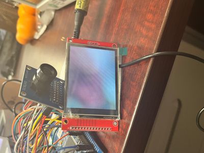

I am currently working on interfacing an OV7670 camera with an STM32F429 using DCMI + DMA, and displaying the captured image on an ILI9341 LCD (SPI interface).
I have successfully confirmed that the LCD itself works correctly (for example, filling the screen with a solid red color).
However, no camera image is displayed, so I suspect there may be an issue with the camera operation or the DCMI configuration.
I am using the following repository as a reference:
https://github.com/PHANzgz/STM32-H7-camera-interface-and-display
Since this project is originally for STM32H7, I have modified the configuration as much as possible to make it suitable for STM32F429.
At this point, I would like to ask whether there are any STM32F4-specific considerations, missing settings, or common pitfalls when using OV7670 with DCMI + DMA.
Any advice or working references for OV7670 + STM32F429 would be greatly appreciated.
Ths is my code.

Fig.1 LCD with red color
Thank you.
2025-12-22 4:48 AM
I was finally able to display the camera image on the LCD, although it is not completely perfect yet.
Thank you very much for your help and support throughout this discussion.
2025-12-22 4:55 AM
My implementation is based on "STM32-H7-camera-interface-and-display".
I tested both single-frame and continuous capture modes.
Single-frame capture works, but continuous capture does not keep running.
I suspect that this approach may have limitations on the STM32F429I-DISCO board.
URL:https://github.com/PHANzgz/STM32-H7-camera-interface-and-display
My code⇩
