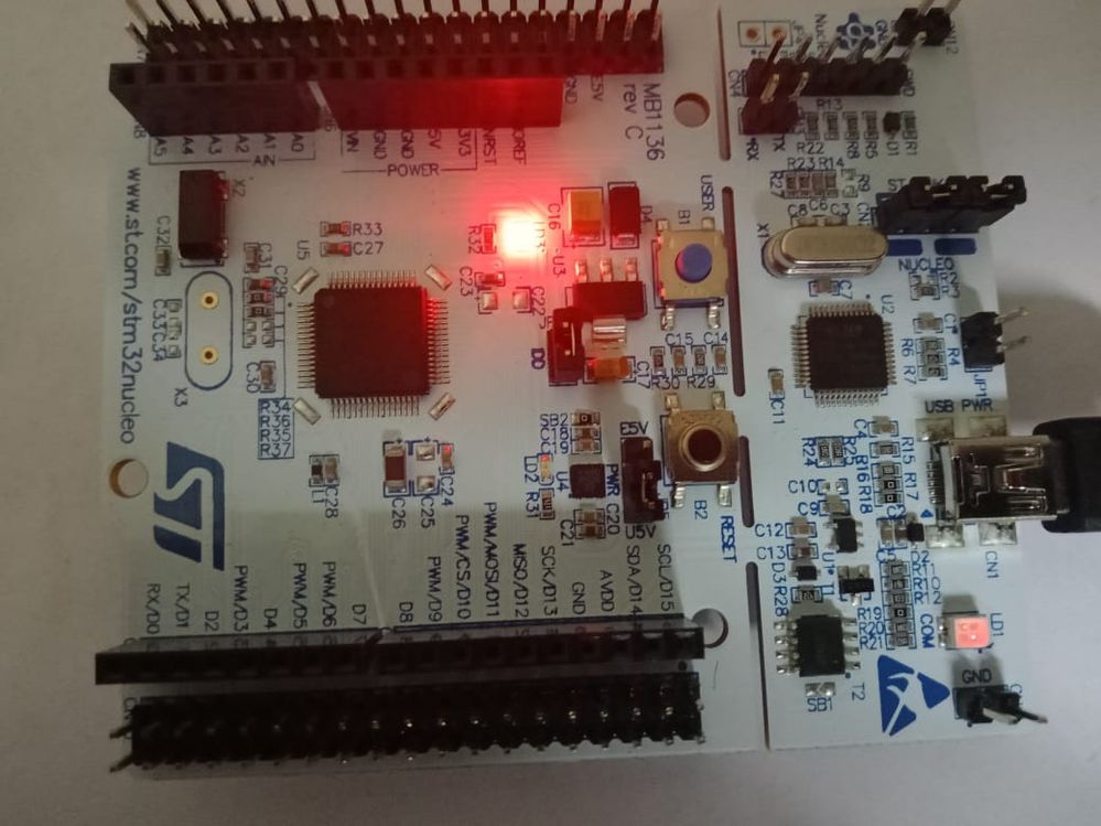

ST-LINK part's LED (LD1) on your STM32f446re Nucleo board appears dim and differently when in debug mode. but in normal, it glow normally and when code upload, it blinks.

Well presumably when debugging there's more interaction on the USB from the debugger causing the LED to modulate between it's GREEN/RED modes.
Is this a problem?

When I enter debugging mode, the green and red LEDs start blinking alternately, which I believe indicates normal activity. However, once the debugger is fully connected and running, the red LEDs (LD1) remains ON but glows dimly instead of brightly.
Please note that:
The code uploads correctly without any issues.
Debugging works properly.
The board functions as expected during and after debugging.
My question is: Does the dim glow of the LEDs (LD1) in debug mode indicate any underlying issue, or is this normal behavior for the ST-Link interface?
I suspect it is common, it's modulating, based on many factors, and I suspect very little effort is made to keep it at frequencies suitable for the human eye. Perhaps scope the signal, see what frequency it's at, and how little the LED is ON
Ideally the debugger should connect as fast as possible, and might be in a loop probing memory, peripherals or MCU registers.
