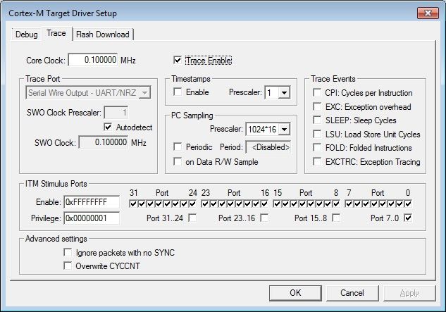

2018-05-18 4:27 PM
Like this?
2018-05-21 6:50 AM
Exactly.
2018-05-21 7:25 AM
Ok, that didn't seem viable of the STM32H743I-EVAL, didn't see any solder-bridge/jumpers there, will try on NUCLEO-H743ZI later.
