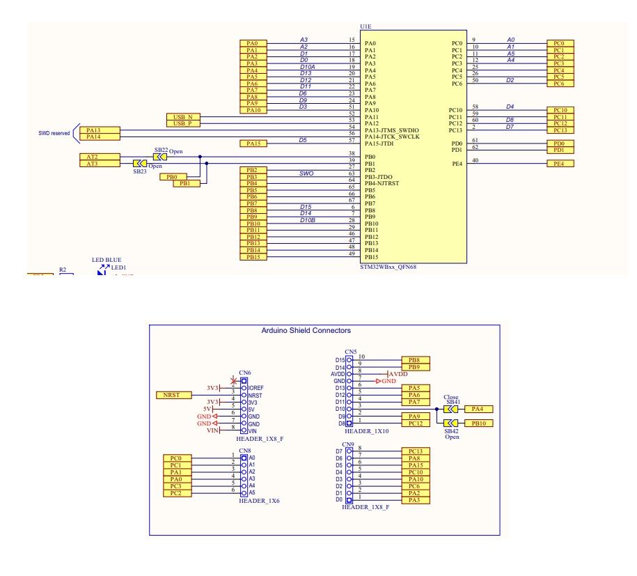

Have you verified that none of the CS pins, especially PA9, is connected to onboard peripherals ?

The question was whether the Nucleo board has anything connected on PA9 ...
2025-06-16 4:44 AM
Ahhh right, the user manual says its function is TIM17_CH1. I'm confused here as the scope trace shows it acting as implemented as a GPIO output.
2025-06-16 6:24 AM
You really need to look at the schematics to see if anything else is connected.
2025-06-16 7:33 AM
From the schematic I cant see that PA9 is connected to any other peripherals or devices on the board
