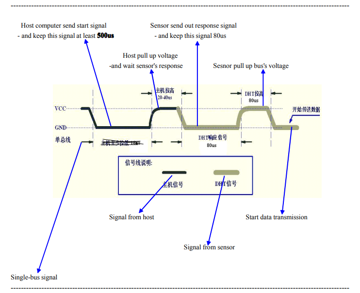

From this datasheet at Adafruit:
It looks like you need to release the line after the initial low - not drive it high ?
Also from Adafruit, "DHT22 and AM2302 often have a pullup already inside, but it doesn't hurt to add another one!"
So is yours one that needs a pullup?

Thanks for your reply, i corrected the uint8_t to int8_t, and made sure that the sensor's data pin is connected to the Vcc through a 4.7 k resistor in the right way, and then tried 2 Scenarios
1- waited for 500 microsec then released the line and waited for 30 microsec.
2- waited for 500 microsec then drove the line higg for 30 microsec.
but i still get the -1 response which means that the sensor doesn't respond correctely.
the first if statement in line 5 checks if the line at this point is low which means that the sensor is sending the 80 microsec low signal. Then after 80 microsec delay, the if statement in line 9 checks if the line is high, and this true only when the sensor sends high for 80 microsec.
