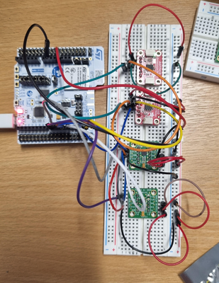

@Ozone wrote:I don't know how long your cabling to the breadboard is.
@NicRoberts This is where the good, clear photos of your setup could help!
Also still waiting to see your schematic.
And solderless breadboards are notorious for poor connections ...

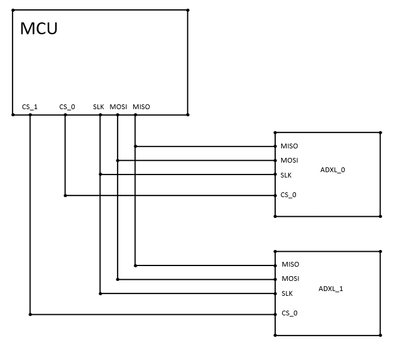

2025-06-11 6:48 AM - last edited on 2025-06-11 7:06 AM by Andrew Neil
Schematic
Picture (shows 2 temp sensors on the I2C1 bus, I disconnected them for the SPI tests)

Your schematic doesn't identify which pins you've used - neither on the Nucleo board, nor the MCU.

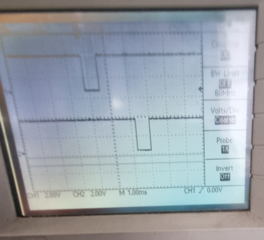

@Danish1 Could it be timing? The delay between asserting CS1 or CS0 and starting / stopping the SPI transfer?
I've but in a 1ms delay after each SPI transfer, see trace below, top CS0, bottom CS1.
