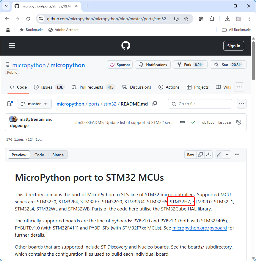

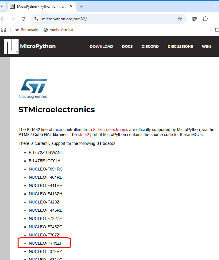

2025-05-06 4:09 AM - edited 2025-05-06 4:11 AM
@Ozone wrote:Notice, the list of boards contains no H variant at all
Oh yes it does:
and their GitHub says "H7" generically:

2025-05-06 5:05 AM
You are right, I overlooked the listed H7 variant - sorry.
