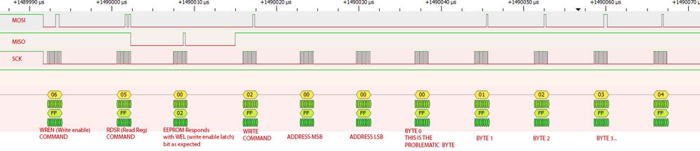

Here is a SPI logic trace of the write command:

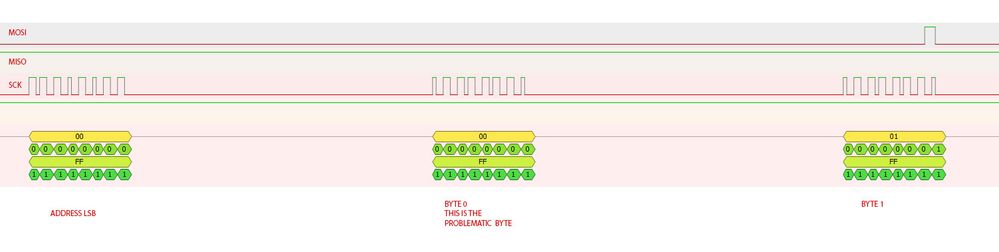

And a close up of the first byte that is not working correctly:

Show the chip select in the context of the signals being diagrammed here
