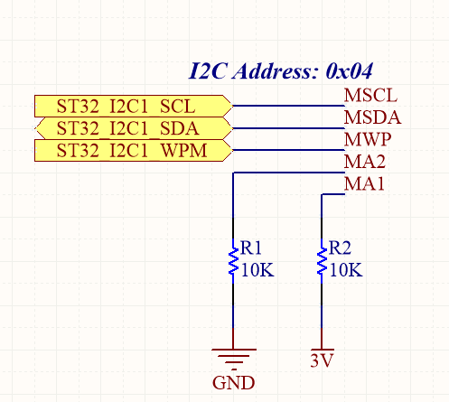

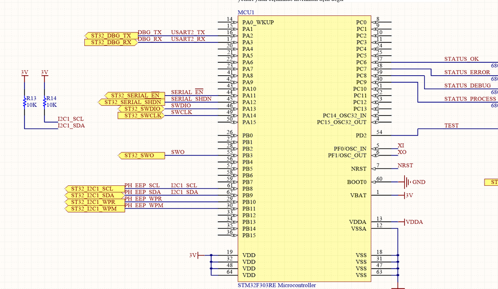

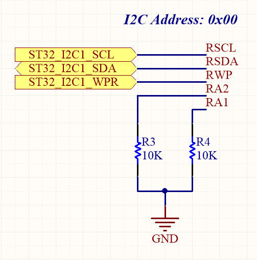

So you have two EEPROMs on a single bus? Do they have set different addresses? Those ROHM parts appear to have model-dependent addressing options; particularly, BR24L04-W appears ignore the A0 pin. Try to disconnect one of them. Try to write and then read back.
Posted on March 16, 2017 at 11:59
Thanks for reply
Waclawek.Jan

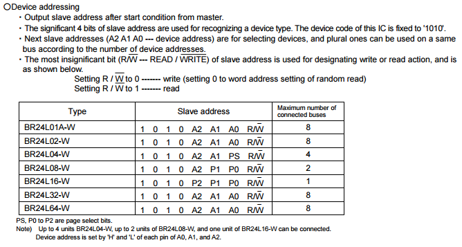

‌ yes there is two same EEPROM on a single bus and the A0 bit is a page bit in BR24L04-W model. I'm not using it and I tried your advice but didn't edit the question. The result is same I'm getting the all ACK bits but when I reading the EEPROM is putting out all zeros. I've tried that on 4 different EEPROMs the result is same in every try. I'm confused. Thanks again.
Posted on March 16, 2017 at 14:41
No more ideas here.
Have you also tried a non-ROHM EEPROM?
Posted on March 16, 2017 at 15:02
No I didn't because I've no other EEPROM. But I'll try with ADXL345 which is have I2C interface.
S.Ma
Principal
Posted on March 17, 2017 at 10:03
So we assume that both eeprom have different pin A1/A2 settings. 0xA0-A1/A2-A3 (Write-Read address depending on the 2x256 bytes page) and 0xA4-A5/A6-A7 (2x256 byte page)
Consider before giving upto try adapting
https://community.st.com/0D50X00009XkW1qSAF
which links to I2C by GPIOs. Do the plumbing for your low level GPIO handling (this code works with various cores) and see if it works.
Posted on March 17, 2017 at 09:50
‌ can you look the edit please. Thanks.
Posted on March 17, 2017 at 10:29
Thanks
Centauris.Alpha
‌. Yes I've different slave addresses which are defined with `const uint8_t DEVICE[] = {0xA0, 0xA4};`
Here are the device addresses and I'm first trying to with one EEPROM so the other one is not connected to the board. I want to send and am trying get datas without GPIO method. But if this is mandatory I'll check it. Thanks again.
Posted on March 31, 2017 at 15:31
Hi All,
I've solved the problem. There is some missing information in the BR24L04's datasheet. Address is not 16-bit so P0 is the page bit. I've though it is 'page reading or writing bit' but it is not, it is used to select first/second page of 8-bit addressable area. The device is automatically increasing the address while reading operation, there is no limit. In writing, just 16-byte could be written sequentially. In both situations, if the device sees the stop, it stops suddenly. I've changed the read function and now read has no problem. Thanks to everyone. Here is the read function, maybe help someone;
