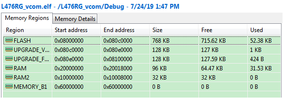

}Now the problem is: the build on Atollic TrueStudio is succesfull: please see the following build analyzer results

thanks, we temporary eliminated this problem, in https://www.st.com/resource/en/datasheet/stm32l476rg.pdf, Chap 3.4, it mentions"The Flash memory is divided into two banks allowing readwhile-write operations. This feature allows to perform a read operation from one bank while an erase or program operation is performed to the other bank. ", here the flash use bank1&bank2 (each bank is 512k), it is possible flash do read/ erase at bank2 while upgrade_var & upgrade_fun is also doing bank2 with different operations (such as flash does reading but upgrad_var doing erasing) ? so we limit flash into bank1 only, and this run error disappear.
This makes me worried about my firmware, it is also possible my upgrad_var does reading while upgrade_fun does erasing!!!!!!!!!!!!, anbody has a final solution for this? thanks
