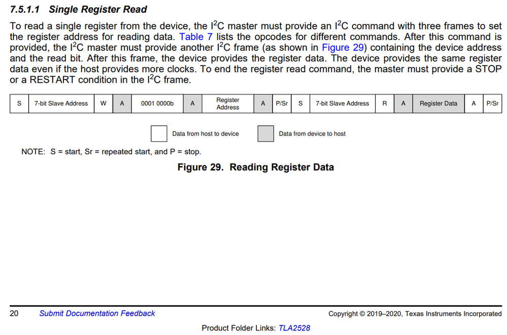

2025-06-27 7:13 AM
The datasheet says that a read should look like this:
