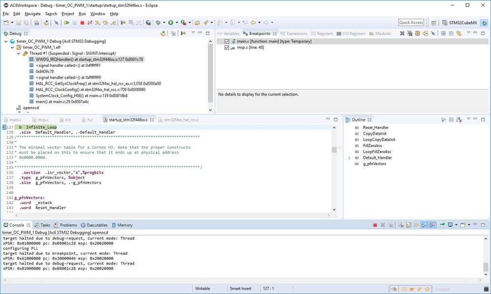

}Now when I build, load the program and try running it in the debugger I see that it is stuck in an infinite loop in HAL_RCC_ClockConfig(...). Why did it go into the WWDG_IRQHandler()?
This EXACT same code runs fine under Keil MDK.

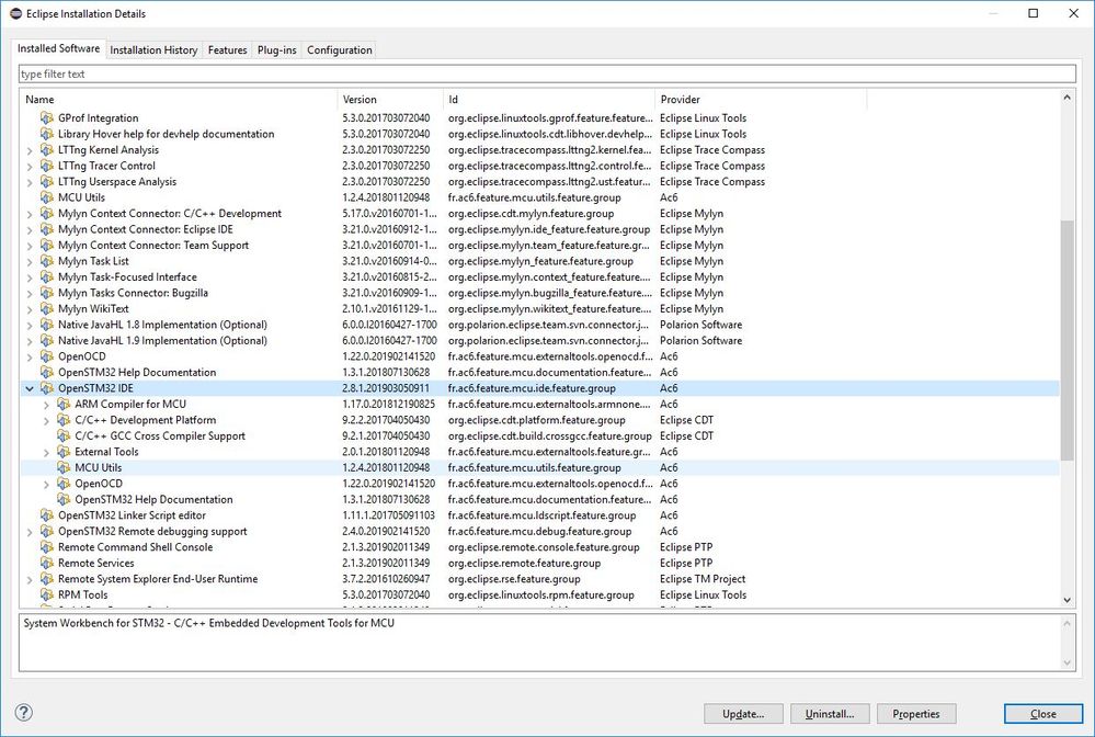

The version of System Workbench I am using is:
Any ideas? I tried it with a previous version of System Workbench and I have the same issue.

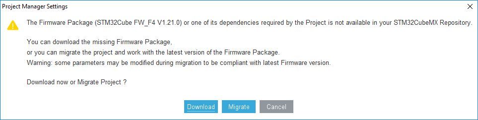

Found out the this project was using an older version of the firmware package.
CubeMX was initially used to generate a skeleton/template and code was modified to be as shown above.
Once the project was redone using the latest CubeMX firmware, it all worked as it should.
