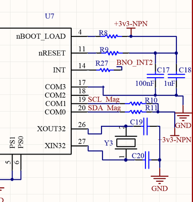

You forgot to attach your schematic.

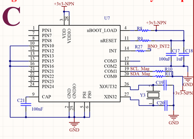

2025-07-08 6:38 AM
I have added the schematic in this way.
My design was created for I2C communication.
Actually, I originally designed it for the BNO055.
I removed the BNO055 and soldered the BNO086 in its place.
As a difference, I left pin 17 unconnected to prevent the sensor from operating in SPI mode.
Is there anything else I need to do?
2025-07-08 6:55 AM
Please show a complete schematic.
The net name "+3v3-NPN" sounds suspicious - what's going on there?
What are the pullup values?
Have you also used an analogue oscilloscope - to see what's happening in the analogue domain?
The sensor also supports SPI & UART - have you tried either/both of them?
Have you contacted the manufacturer for support?
@CANZT-FD wrote:I removed the BNO055 and soldered the BNO086 in its place
So have you checked carefully for any damage in that process; shorts; poor joints; etc ... ?
Are they supposed to be "drop-in" replacements?
@CANZT-FD wrote:As a difference, I left pin 17 unconnected to prevent the sensor from operating in SPI mode.
Was that not also required for the BNO055 ?
Suggests not just a drop-in replacement?

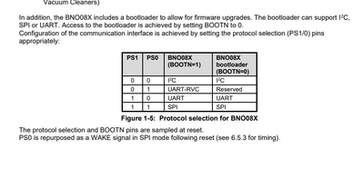

2025-07-08 10:58 PM
Thank you for your response.
I’ve attached the schematic for the 3.3V NPN configuration.
When I check with a multimeter, I can see the 3.3V sensor supply voltage.
My current design does not support SPI or UART, so I’m unable to change the hardware layout.
I am required to use I2C.
The pull-up resistors are 10kΩ (I also tested with 2.2kΩ, but it didn’t work).
I soldered the sensor chip and checked for shorts or other issues, but I couldn’t find any problems.
There doesn’t seem to be an issue with the STM32, because when I run other I2C code, I can observe activity on the SDA and SCL lines.
However, when I run the BNO086-specific code (such as the one above), I don’t see any signal at all on the lines.
I’m beginning to doubt whether I’ve written the code correctly.
I’m not sure if the issue is due to the BNO086 using the SH-2 protocol.
The image I previously mentioned was taken from the BNO086 datasheet—my apologies for the incorrect information.
Pin 18 is defined as the SPI\_SELECT pin. I have left pin 18 unconnected.
This is the current situation: I am unable to get any response from the sensor, and I can’t determine whether the issue is hardware- or software-related.

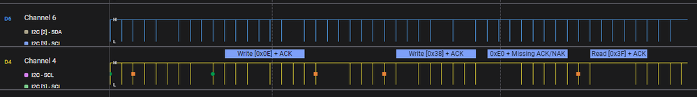

2025-07-09 11:11 PM - last edited on 2025-07-10 2:55 AM by Andrew Neil
Merged with original thread.
I opened this thread as a continuation of the discussion here:
https://community.st.com/t5/others-stm32-mcus-related/i-couldn-t-get-my-bno086-to-work/m-p/820144/thread-id/7443
I’ve attached logic analyzer captures showing what I observed on the SDA and SCL lines.
yellow=SCL
blue=SDA
mcu=stm32u5
SDA SCL resistor 10kohm

Please don't do that - it confuses the issue by spreading the necessary information over multiple threads!
You still haven't shown the full schematic, nor given the full part number of the STM32.
Have you looked at the I2C lines with an oscilloscope?
You said originally that there was "no activity at all" on the I2C lines; now you're showing that there is activity - so what's changed?
How does what your logic analyser shows compare to what the sensor datasheet specifies?
How does what your logic analyser shows compare to what you were getting with the other sensor ?
