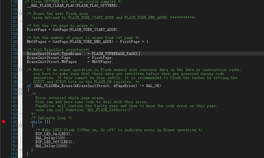

i'm using stm32c011f4u6 mcu's DK(stm32c0116dk), and i generate the file as mdk-arm and it's running with keil5.
i tried erase to test the flash memory, but it doesn't work. i even used the SDK example file, and i get the same error.
Below is the main.c file.

An error occurs in the function including breakpoint in the picture above. if i run the program, i'll be stuck in that infinite loop.
Why is this problem happening?

2024-04-22 12:22 AM
Hello @KenLee and welcome to the community :),
Do you encounter the same issue when using STM32CubeIDE toolchain?
I think that this issue of Flash Erase in Keil is due to breakpoints.
Could you please try to disable this behavior by following the instructions provided here.
Also, I recommend you to take a look at this discussion may help you.
Please let me know if the issue is solved.
Thank you.
Kaouthar
2024-04-23 12:03 AM
Thank you for Reply.
As you said, it is works well in CubeIDE. But, in Keil5, Unlike the contents of the link you sent me, an error occurs even though there is no breakpoint when debuging.
Also, errors do not appear on other PCs that use the same code and compiler. then, it is hardware problem? i'm really confused.
2024-04-23 12:48 AM
Hi @KenLee ,
Thank you for updating post.
I think that the problem is more likely related to the software environment or configuration on the specific PC rather than the hardware, because the issue is not consistent across all PCs and all toolchain like STM32CubeIDE.
I suggest you to compare the configurations and software versions between the PCs to identify any discrepancies.
Could you please try to reinstall keil and to use FLASH_EraseProgram example of STM32CubeC0 V1.1.0.
Note that, this example is developed with MDK-ARM toolchain V5.36 as mentioned in the release note.
Thank you.
Kaouthar
2024-04-23 7:18 PM
Thank you for your response.
As your advice, My MDK-ARM toolchain version was not V5.36.
I checked the version when I installed the SDK, but I guess i was mistaken for something.
Anyway, After changing the version to V5.36 and trying again, the program works very well now. Thank you!
