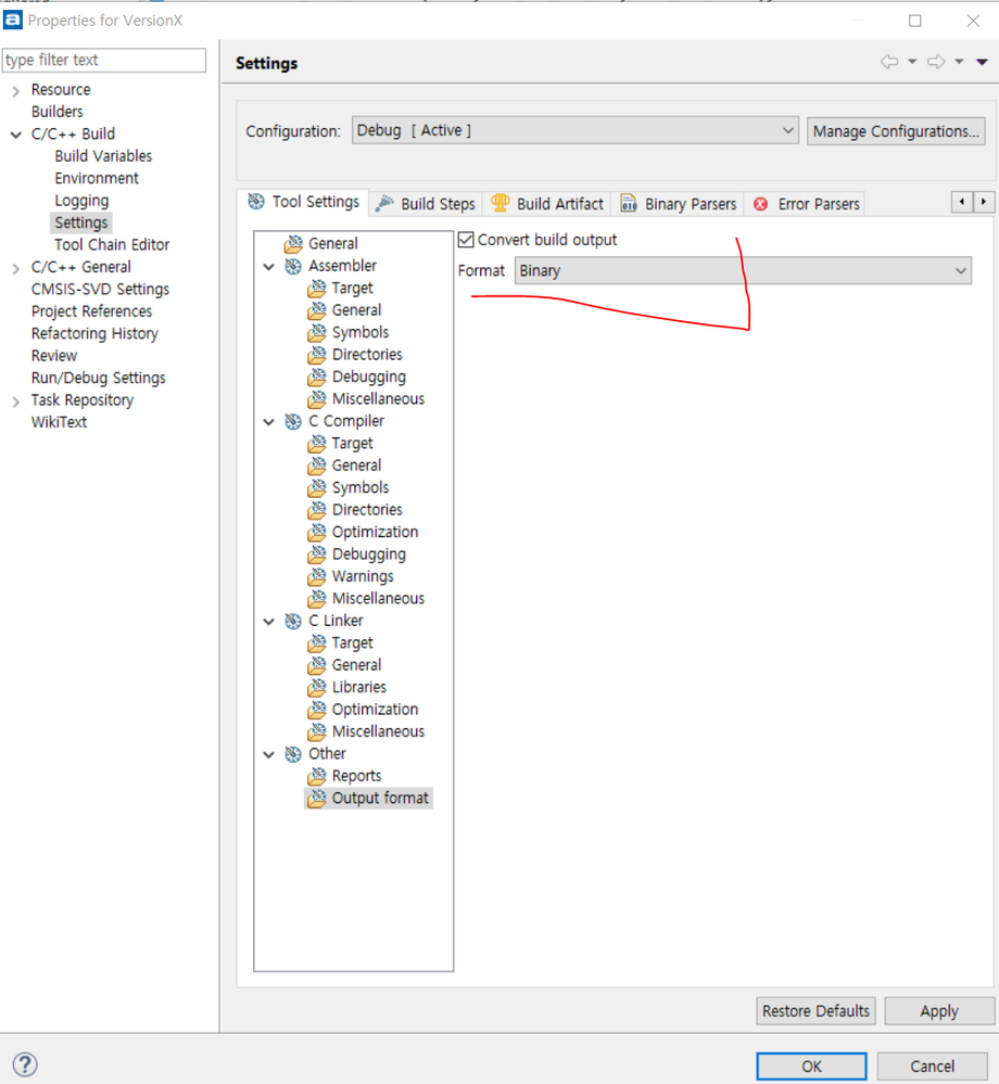

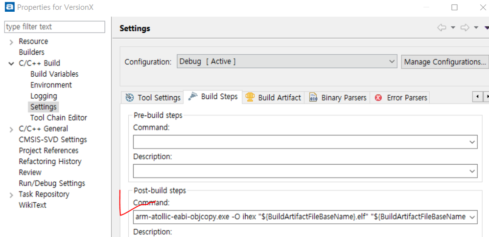

i want to make *.bin file for download into stm32L433 chip.
so,
i have to change below option or
i just change below check option
please give me information
thanks a lot

With 1st method Post-Build Step):
You can invoke oblcopy command
arm-atollic-eabi-objcopy -O ihex ${BuildArtifactFileName} ${BuildArtifactFileBaseName}.hex; arm-atollic-eabi-objcopy -O binary ${BuildArtifactFileName} ${BuildArtifactFileBaseName}.bin
Or select Binary format converter into Output converter
