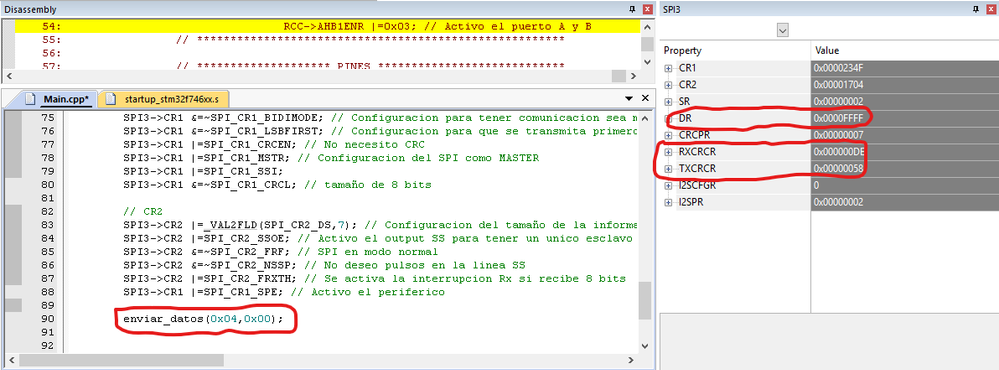

Hi thanks4opensource, thanks for answer me. I see that you are right about the baud rate, my hex are wrong, i fixed it and prove but doesn't correctly run. i mean, i use my send funtion and in the debugger on Tx Fifo i look that isn't the same. ( i adjunt the photo of the debugger) . if you see, i send 2 bytes, 0x04 and 0x00, in the right i see the state of the register, and Tx Fifo should be the same with the information that i send but it's too different.
you said about the RCC register, i only turn on the SPI3 clock with the RCC->APB1ENR, if you refer to another please can you said me what it is? and the last, can you sow me communication code ? is only for check the irregular things
