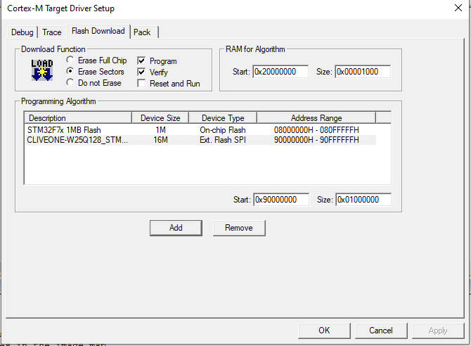

2021-05-22 4:49 PM

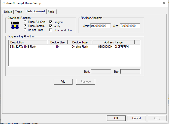

2021-05-23 4:25 AM
After adding the file .flm to the program and pressing OK, it will disappear from the list automatically
after
2021-05-23 5:45 AM
2021-05-23 6:06 AM
I'll set up a Nucleo and test later.
Try renaming to TEST.FLM
Change the RAM allocation to 0x4000
5.33 Didn't appear to be losing the the algorithm
