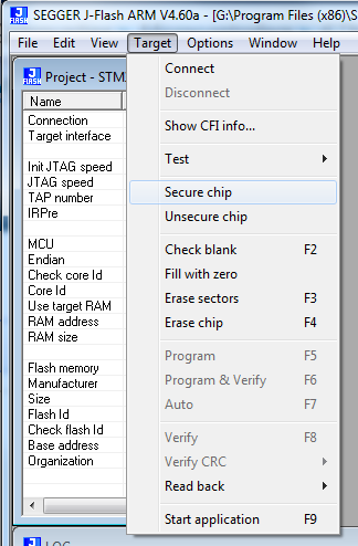

Thank for your answers.
1.I want to protect my code versus extraction methods.2.I want to use eeprom emulation(use flash for data read and write) too.I said: ''I dont understand flash sector lock or unlock and read out protection relations'',Can tell me what the meaning of flash sector lock and read out protection difference?I secure the chip with jlink program menu:2014-03-28 6:05 AM

Thanks.
OK,I want read out protection and write to some page of flash at runtime.So ''secure chip'' don't solve my problem at all.I want to use EEPROM_Write... and its not work on this mode,but I have another question: Is ''secure chip'' protect the code from read out?,because I cant read mcu in this mode with debugger or program it in uvision.All of flash will be erased after ''Unsecure chip''.Is there any way that I can use ''Read out protection'' and write in flash at runtime?how can I enable read out protection(principled way)?Thanks.2014-03-28 7:55 AM

I found this function on flash peripheral library:
FLASH_ReadOutProtection(); This function change option byte and then,readout protection has been activated.
There is no write protection flash page in this state,and work with eeprom emulation without any problem.
There is a tip in ReadOutProtection: Mcu needs power on reset after set readout option byte.
reset pin,or other reset solution don't reload option byte,
only
power on reset
reload readout protection data. ''J-Link secure'' enable readout protection and flash write protection.We need only readout protection in eeprom emulation.So its not useful for this thread. Thanks for your answers. Problem Solved.We’re moving the ST Community to a new platform to give you a better and more reliable community experience.
