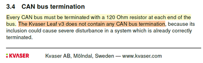

@mƎALLEm  I just checked the Kvaser manual, the Leaf v3 does not have terminating resistor.
So I'll add another one...
If you have already two terminating resistors of 120ohm on the bus you shouldn't.

I only had the Kvaser and my device on the bus, so only one R.
With 2 Rs still the same.
I'll contact Kvaser, thanks for the link!

Problem solved, Kvaser replied, saying that definitely 2 terminating resistors are needed on the bus, and:
When using CAN FD it is extremely important that ALL nodes on the CAN bus use exactly the same settings.
That was it, I didn't know that. I thought the sampling point might be something device / interface / endpoint specific.
Luckily I made all bus parameters editable (via http PUT), so when setting the sampling point to exactly the Leaf's settings, it works.
Thanks to @mƎALLEm and to Kvaser for the quick replies! :)
