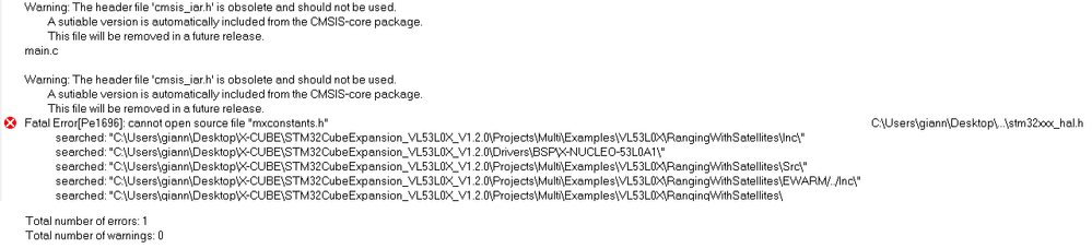

In this moment. after these steps, if I compile the code, there is 1 error, it is: ,
Fatal Error[Pe1696]: cannot open source file ''mxconstants.h'' ,
