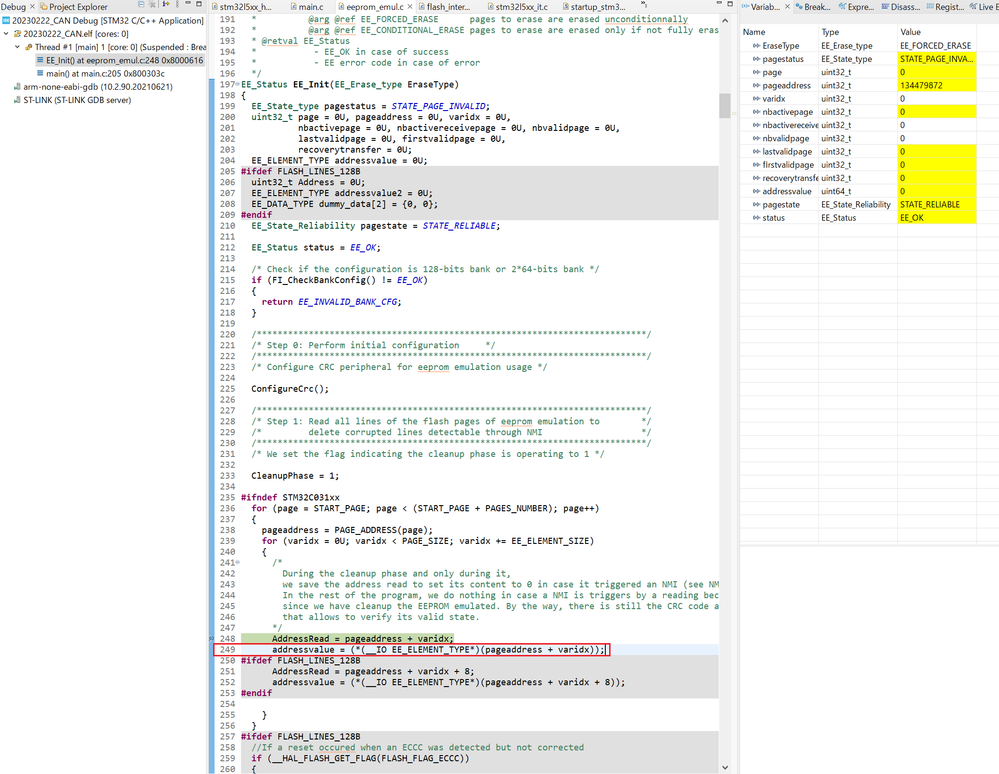

I am trying to use this sample for STM32552CCT6 to run EEPROM Emulation, but the EE_Init() execution results in an error.

A Fault occurs when line 249 in EE_Init() is executed.

The error was due to accessing an impossible address. Resolved by resetting the user-defined start address to the correct range.
