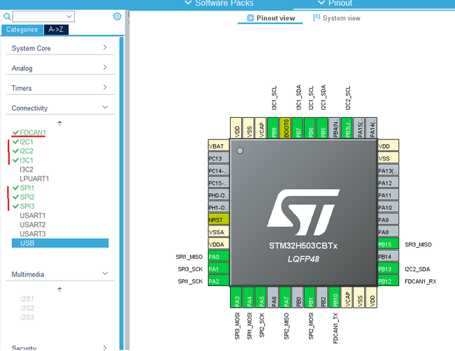

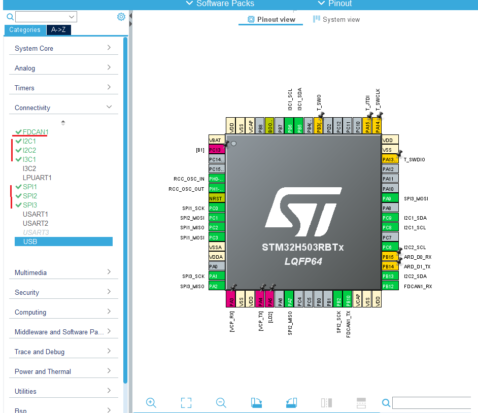

Hello @gianlucamilani and welcome to the ST community,
STM32H503 could be a condidate for your requirements as shown below with CubeMx:
1 x FDCAN
2 x I2C
2 x I3C that you can use them in I2C mode
3 x SPI
You can use them in parallel:
There is a NUCLEO board for that part number: NUCLEO-H503 board with LQFP64 package. There is no NUCLEO with LQFP48 package for any STM32.
If you need LQFP48 for your final project, that package allows you the same confguration in parallel:

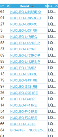

> 3 × I2C
> Compact (48 pins)
According to STM32CubeMX, there are no nucleo boards in an LQFP48 package that have 3x I2Cs.
Download STM32CubeMX and use the product selector to sort through chips and available board.
If you relax this to only 2x I2C, there are quite a few:
Any will work. The STM32U0 series is a good balance of new/simple, in my opinion
Advice: Stay far away from STM32C5 until it has good support. Stick with STM32CubeMX-compatible chips.

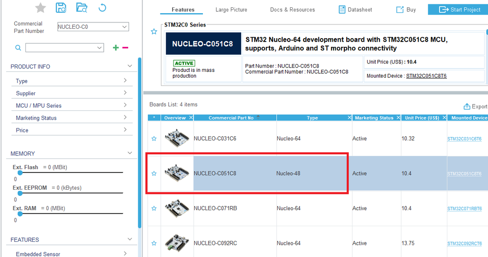

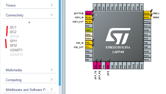

There are a few on the STM32C0 family. Here is one:
NUCLEO-C051C8 | Product - STMicroelectronics
My filters must not have been set right in my first reply. In my previous screenshot, those aren't all LQFP48.
2026-03-19 1:38 PM - edited 2026-03-19 1:41 PM
Indeed. I was not aware of that configuration.
But unfortunately that doesn't fit the OP requirements:
