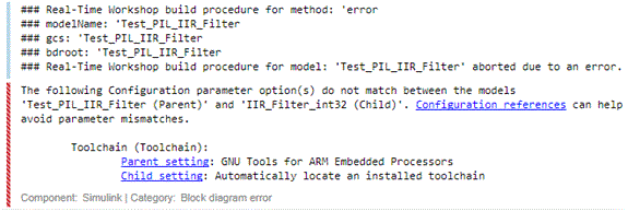

I'm trying to run the "Test_PIL_IIR_Filter" example and during the build I get a configuration error for the toolchain used by the parent file and the child file.
In the configuration parameters window, the selection menu is grayed (not available). How can I change the toolchain for the child ?

This problem is not reproduced with the version 5.1.0 of STM32-MAT/TARGET, published end of July 2019.
While working on this version the followings tests were successful for PIL:
- F429ZITx @ 180 Mhz, USART1: OK
- L476RG @ 80 Mhz, USART2: OK
Regards.
