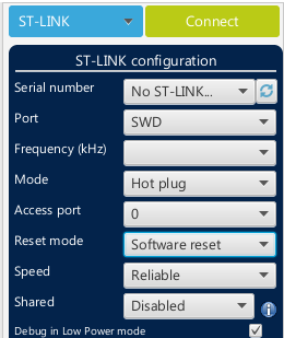

2026-01-19 2:17 AM - edited 2026-01-19 2:48 AM
>Symptoms: MCU sometimes stops responding
1. might be a hardware problem (spike coming in, maybe even on ground connection) ,
or your software doing something "legal" (= no hard fault generated), like (what i already produced) looping in an INT waiting for a signal...that never comes (or was just a ns spike, triggering the INT ).

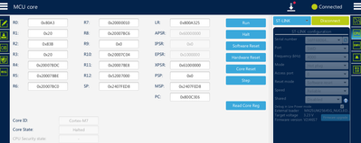

2. besides the tips you got....you can connect in CubeProgrammer to the "stuck" cpu without reset:
..in hot plug mode. Just to see: where it is and is it still running/working;
so you can come closer to find out: hardware spike puzzling the core or just hanging in an INT.

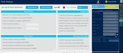

here on H743:
RUN lets it just run on - where it was executing....whatever. :)
And checking for hard fault:
