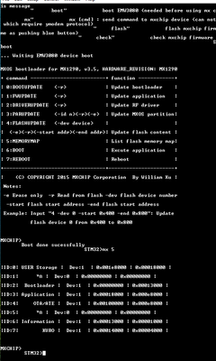

Just wanted to include this photo from running the update fireware and getting the memory mapping, this doesn't seem right but I don't know if this would causing the problem or how to fix it if it is.
