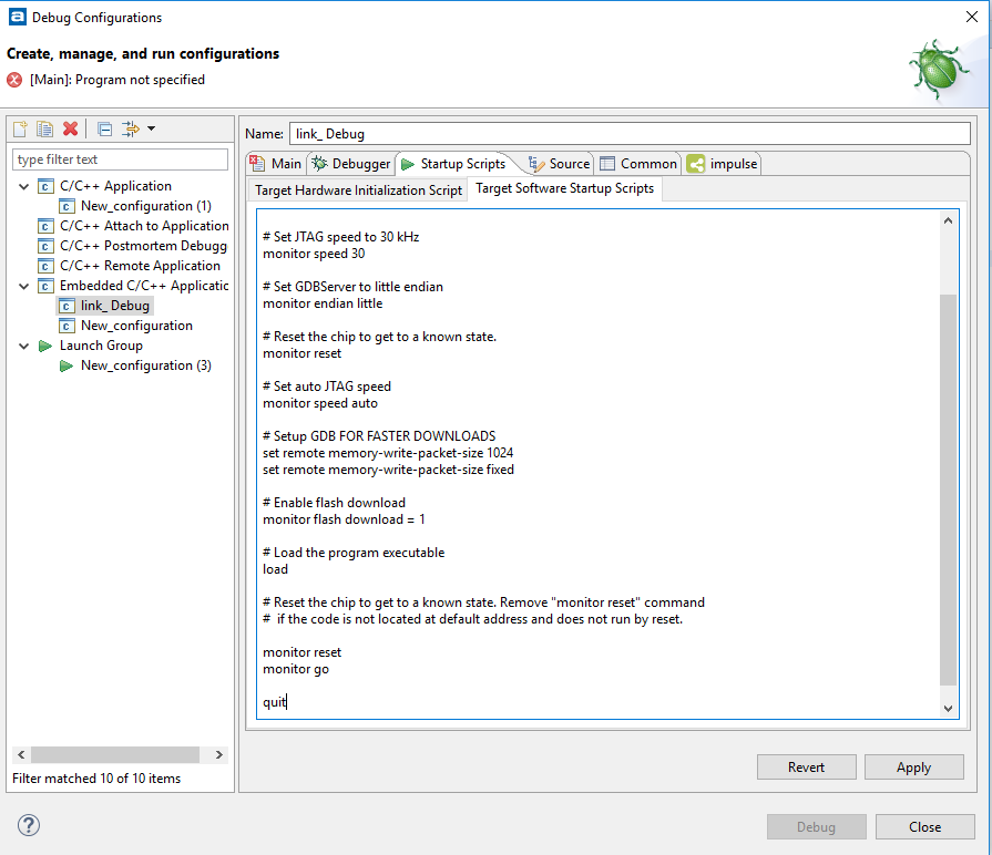

I solved a problem. At first I created new embedded debug configuration, then I edited Startup script.
Behind ''load'' command I deleted all default commands and I added this commands :
monitor resetmonitor goquitThis configuration you can call RUN.
Run without debug is working now.
