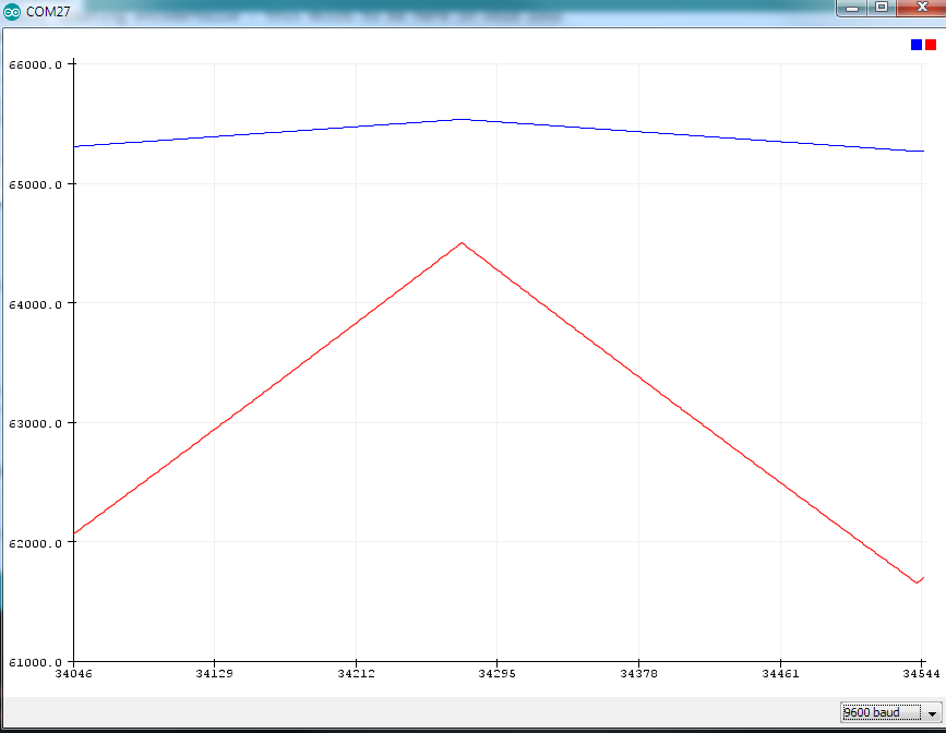

I have an optical encoder that updates a variable which I use to change the value of pwmWrite and 2 LEDs conected to PA8 and PA9 fade up and down according to that value.

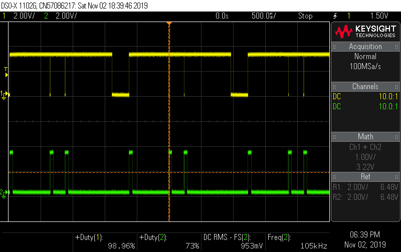

}This seems to give me 16bit PWM output from PA8 and PA9 (LED1 and LED2) but looking at it on my scope it gives me all kinds of weird down-going spikes while the encoder is turning that I don't see at all when using the MAPLE core.
It's fine as long as the encoder is not turning though.
The encoder code isn't spitting out random zeros either because if I plot the value being sent to PA8 and PA9 in Serial Plotter it creates perfectly smooth lines.

There is not much Arduino-specific knowledge on this forum.
Maybe you should go to the source of those libraries, and try to find help there.
If you are willing to find and fix the root cause of problem yourself, dig down to the functions that actually manage the PWM, and find out how exactly do they work. Then, if you post relevant snippets of code, or links to its sources, we might perhaps try to work out what's wrong and how could that be fixed.
