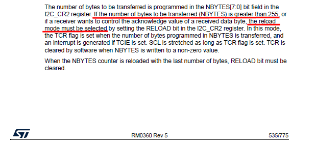

@Andrew Neil Although, I think, the 255B limit is not part of the I2C specs, all the ST MCUs I came across have this hardware limitation since the internal I2C interface byte counter (I2C_CR2.NBYTES register) is 8 bit only.
2024-08-20 7:36 AM
I see.
But that's just a limitation of the STM32 - nothing to do with the M24M02E-F EEPROM.
How to get around the limitation:
2024-08-20 4:16 PM - edited 2024-08-21 12:14 AM
@Andrew Neil Thanks for pointing this out. It was not a must, but it was was a good motivation to improve my i2c driver. Now the whole thing works like a dream.
