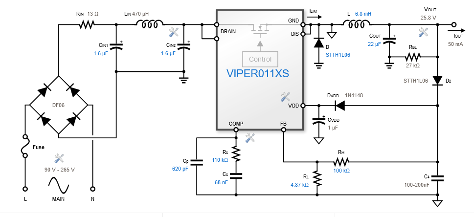

0693W00000LxkCPQAZ.pngCould someone explain why POWER EARTH and GND (PIN 1) are tied togheter?
This not make sense for me.

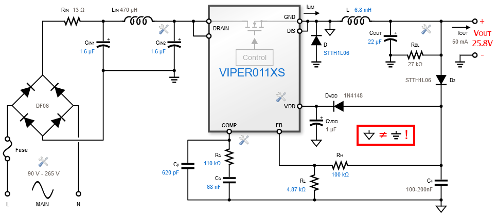

The best way to show this is with a drawing:
0693W00000LxkpgQAB.pngRegards

Welcome, @APC.1​, to the community!
You got confused by the symbols:
  • the three dashes of different lengths indicate power earth
  • the small white triangle is an internal connection of the schematic that must not be connected to ground
This representation was chosen because the VIPer011 is actually a flyback converter whose GND pin is not connected to GND in this buck converter, but realizes the output.
Does it answer your question?

We need to conect +VOUT 25.8VCC and power earth instead GND?
Peter BENSCH
/Peter
APC.1
Associate II
Great!! exactily what I did.
