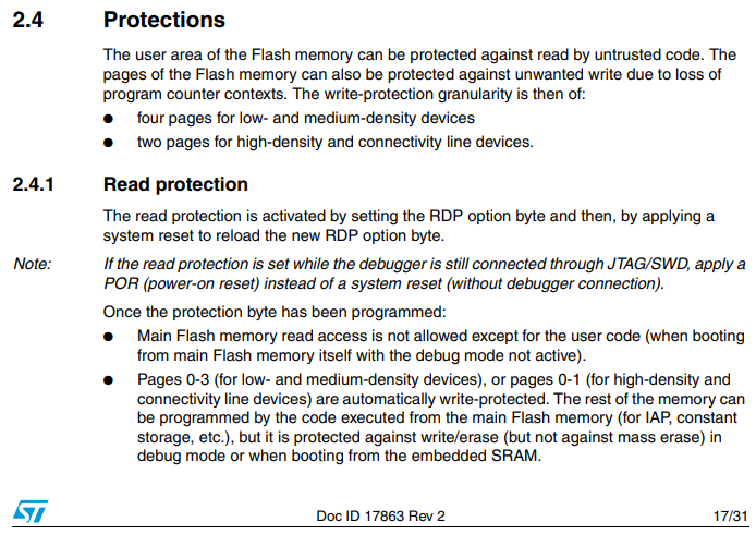

@ludemon wrote:the fact that I disabled read out protection in Option Bytes caused the flash memory to be erased. .
Indeed - that is the documented behaviour.
Think about it: if you could simply bypass the readout protection by just editing the option bytes that wouldn't provide any protection at all - would it?
@ludemon wrote:it seems that if the code is read protected I can't do anything anyway.
Indeed - that is the whole point of protecting the code!

2025-07-08 9:05 AM
It's a feature of the chip - documented in the Programming Manual:
