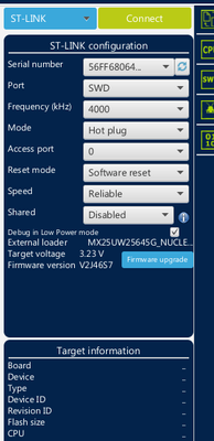

Here is what it says. I even used both my ST-Links

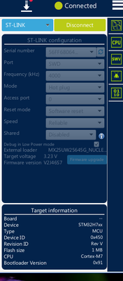

nono...you should show this:
connect ->
...here connecting a st-link "stick" to H743 cpu
freddy20
Associate II
You should set it to:
- software reset
- mode: normal or hot plug
--- because: these st-link have no working hardware reset !

That didn't work somehow. Here is my whole CubeProgramer
