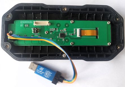

I'm not using a Blue Pill board. I thought that was for development purposes.
The photo shows my ST-Link connected to the existing board via GND CLK DIO VCC port.

That’s unfortunately not a genuine STLINK.
