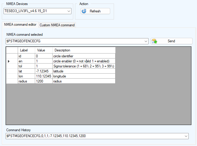

However, now I got another issue. I'm trying to set geofence using $PSTMGEOFENCECFG and it says $PSTMGEOFENCECFGERROR*06 and here's the command that I sent to my Teseo.
Do you know where did I go wrong? I'm kinda lost since it only says error without any details.
2023-02-12 8:06 PM
May be, ID should start from 1?
2023-02-12 8:08 PM
And radius value format as double: 1200.0?
