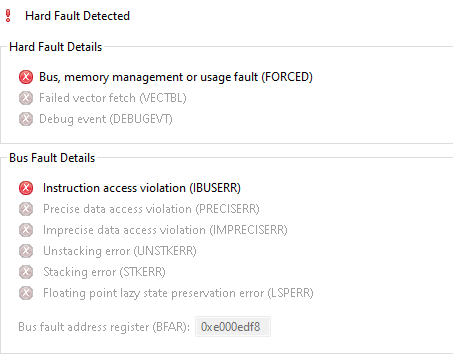

2024-10-14 8:44 PM - edited 2024-10-14 8:45 PM
I have tried terminating and creating the same thread using osThreadTerminate and osThreadNew, but i am entering into hardfault.
Is there any method to recover it to the right instruction and stack pointer.
