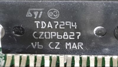

Peter BENSCH
Welcome @petarp, to the community!
Please check whether pins 5, 11 and 12 (pin 1 = left with tab at top, view on the marking side) of the defective TDA7294 are open or whether there is a track connected to them:
  • If they are open, you can replace it directly with the TDA7294V
  • If there are tracks connected to them, it was the TDA7294S, which had additional bootstrap and clip detector functions and for which there is no replacement
The mica sheet is actually used to isolate the tab, which is internally connected to -VS, from the heatsink. You can replace it with another thin insulating sheet, e.g. thermal pads as used for M.2 SSD or similar. After installation, please check that there is no electrical connection between the tab and the heatsink.
Hope that helps?
Good luck!
/Peter

I had some free time, so I dissasembled the woofer of Logitech Z-5500, since that is where the amp board is.
I took a picture of the IC. It sais TDA7294. Please take a look:

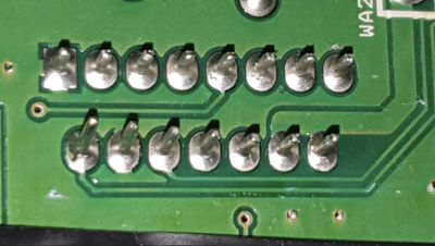

Here is the picture of the IC (TDA7294) at the 'bottom' side of the board:
Peter BENSCH
You have already measured correctly. However, you can only recognise a few connections on your photo of the bottom side (odd pins in the top row with 8 pins, even pins in the bottom row with 7 pins, pin 1 at the top left):
  • pin 1 = GND
  • pin 2, pin 5, pin 9: tracks to anything
  • pin 12, 14 = connected to each other
Because of the last point you measure a short circuit between pin 12 and pin 14.
However, I don't think we need to look any further for differences to the TDA7294S, as it was almost certainly also labelled TDA7294S, so my first statement now applies:
Good luck!
