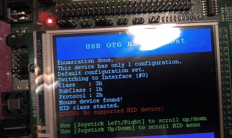

I was able to to load the CUBE code for HID host demo on my board. I found the function you suggested to change. I changed the time out but that did not help as well. Attache please find the captured display.2014-06-11 4:04 AM
