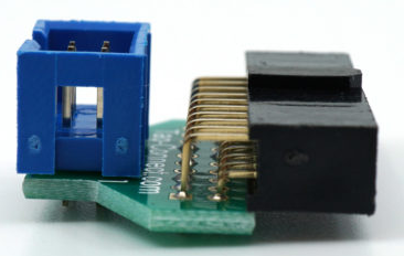

I am using STLINK V2 & using SWD for flashing. Please can you confirm if Tag-Connect ARM20-CTX & TC2030-IDC are compatible to STLINK V2.
2024-04-29 5:48 AM
They're just passive pinout adaptors
The connections are listed in the datasheets; eg,
https://www.tag-connect.com/wp-content/uploads/bsk-pdf-manager/ARM20-CTX_19.pdf
The ST-Link pinouts are in the UM1075 User manual:
