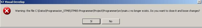

I'm having some problems with it. The problem is that randomly it starts to fail when you try to save any file (project, .c , . h files, etc). It happened to me 3 times already in the few days that i'm using it. One of the times one of the files was directly gone (deleted from disk) so i need to create it again (lucky that it was a .h file). I'm a bit scaried with it.

Here we go... I got it again
2012-06-04 9:37 AM
It previously show ''Violación de recurso compartido durante el acceso a <path>\MFC2D5.tmp''. It is translated to something like ''violation in access to shared resource <path>\MFC2D5.tmp'' with just an accept button, then you press then accept.
After that you get the above window, and logically you press no... anyways this time i save to clipboard the file previosly. After that if you try to exit from workspace you get errors from st IDE ... AND THE FILE IS GONE.2012-06-07 7:24 AM
