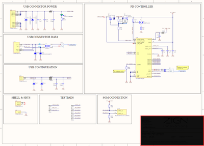

We are using the STUSB4700 in our PD implementation as a source. We have encountered an issue where it seems like the output is constantly switched on/off/on/off with about 500ms on, 200ms off timing.
Below is the schematic which connects to a USB type C connector and a SoM. Please note that we are aware that PD_1V2 should not be connected to the gates of the power FETs and we have patched this on the board we are testing with. Also, to make sure there is no interference from the SoM, the reset and alert line have been cut as well.

2024-10-22 12:27 AM
Hello
Vs description you are providing, it seems that voltage does not raise as expected so that stusb4700 detects a monitoring issue which explains VBUS_EN_SRC going high.
I do not see in the schematic how PD_GPIOx nets are connected to power supply, in order to change the regulation point and output correct voltage, vs negotiation done and I suppose that there are PDOs above 5V
Can you please provide this part of schematic ?
Best regards
Nathalie
2024-10-22 12:34 AM
Hi Nathalie,
Makes sense, we might be missing something in that regard.
The PDOs are all left on default.
The GPIOx are all floating and connected to testpads. This is the full schematic:
We are not using the GPIO configuration as as of now we do not expect to be using voltages above 5V.
