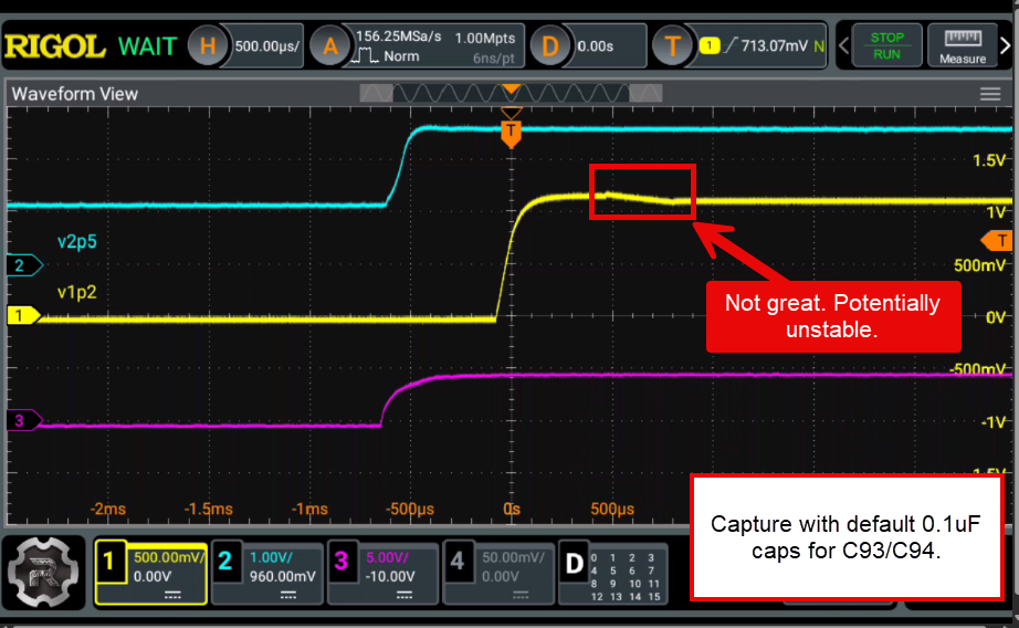

2026-01-13 7:20 AM - edited 2026-01-13 7:20 AM
Thanks Nathalie.
Do you think this could be a regulator stability issue? And do you think that instability could cause permanent damage? On the boards we have with inoperable STUSB4500s, the damage seems permanent. Here is a rampup curve we captured on an undamaged STUSB4500 with 0.1uF regulator caps (ignore 2V5 text, its 2V7).
Ultimately, we are curious if 0.1uF regulator caps permanently damage the IC. Thanks!

2026-01-13 11:02 AM
So potentially, in an out-of-regulation state, do you think VREG2v7 LDO could pull enough current to fry the VDD input (bond wire)?
