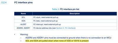

You can pulled up these pins (SDA and SCL) up to 6V (4.5V max would be better as a steady state), it will not impact the chipset.
Nevertheless, if the STUSB4500 is not supplied (no charger connected), be aware that you will get a leakage current on SDA and SCL pins (few hundred of µA), it will impact SDA and SCL level (from 3.3V to 2.7V if you use 3.3kohms resistors). You may use smaller pull-up resistors values (1k or 470ohms for instance) to limit this voltage drop.

Datasheet says they're pulled down when VDD is not present. Probably this is by a protection diode in which case the system isn't going to be pulling them up without powering VDD. Backpowering through protection diodes should be avoided.
