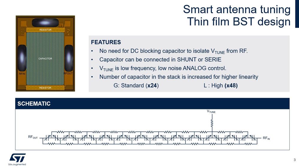

If, for example, RF1 is biased at 5V DC, and RF2 is biased at 3V DC, what will the be reference voltage to the "bias" pin?
2020-12-07 5:44 AM
Please see internal schematic
if RFin and RFout are not using the same DC voltage there will be leakage current
