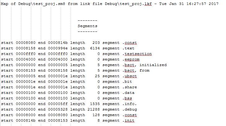

Hi Luca,
thanks for the answer,
My map file for the new section:
start 0000fff0 end 0000fff0 length 0 segment .testsection
length 0 and start and end address the same?
2017-01-31 6:53 AM
I have done exactly the same thing and it works as expected for me:
start 0000fff0 end 0000fff2 length 2 segment .testsection
make sure there's no trivial problem (like you are linking something different from what you are compiling, like different directories or similar problems) and also that, in the linker file, the segment definition comes before the name of the object file that contains your special section.
Luca

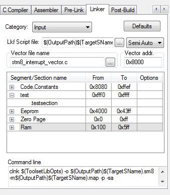

Hey Luca,
I add the new segment with STVD (Project->Settings->Linker->Input), did you add there any options?
I recompiled the whole project with STVD.

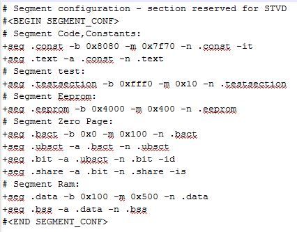

My Linker file:
Based on this linker file the map file was generated:
This code was added in the main.c file as a global definition:

2017-01-31 8:41 AM
try to add a -k on the segment line in the linker file (through stvd or manually):
+seg .testsection -b 0xfff0 -m 0x10 -n .testsection -k

2017-02-01 12:00 AM
Hi Luca,
adding the option -k into section was the problem, together with this option it works.
Many thanks for the support
