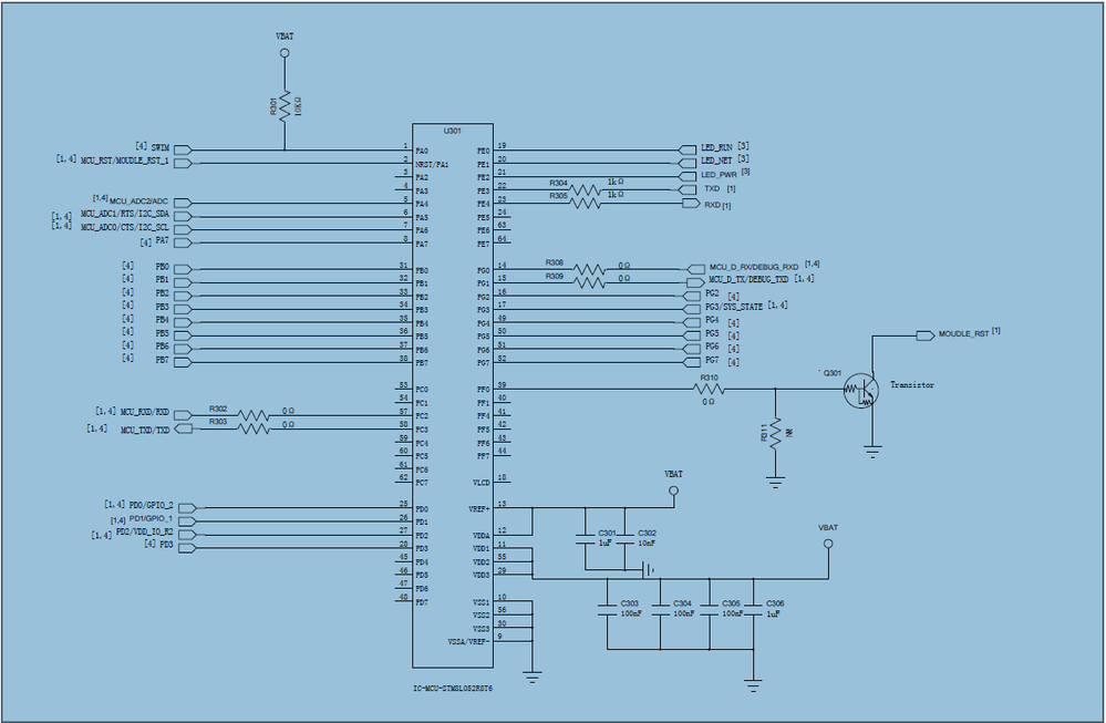

I'm developing an application with STM8L052R8 MCU now, and this application is battery-used product. The problem is that, I cannot make the MCU consume micro-ampere order current.
I used every methods described in the reference guide manual, including active halt mode, and halt mode, but the least current indicator displayed 250uA. Of course I have stoped HSI, LSI, all timers and disabled all interrupts,disconnected other devices. GPIOs are also retested as push-pull low-slow output mode. I'm confusing.
