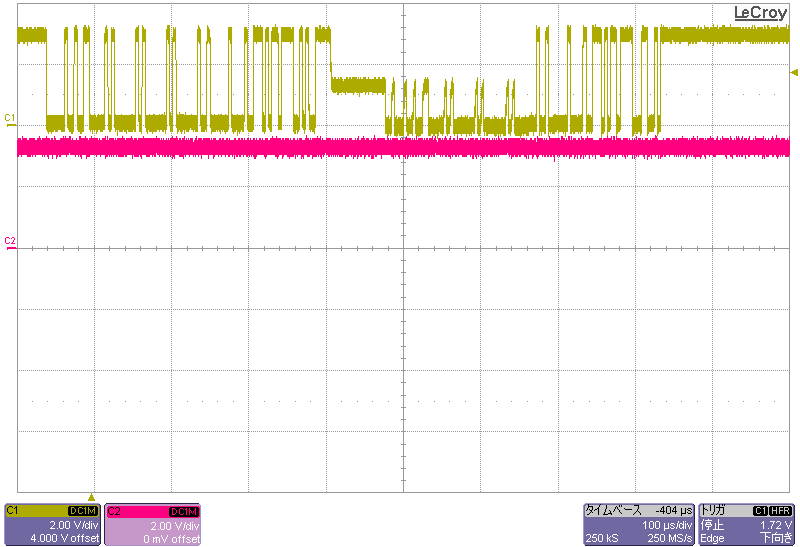

I have a problem with USART half duplex. The output from my STM8L device is too strange.2013-08-30 3:13 PM

The host is slow in tri-stating the line after transmission it appears to be pulling it low for a while. When your device enables its transmitter and tries to pull it high the voltage goes to the mid point. You can see later on when the host eventually tristates that the levels recover.
